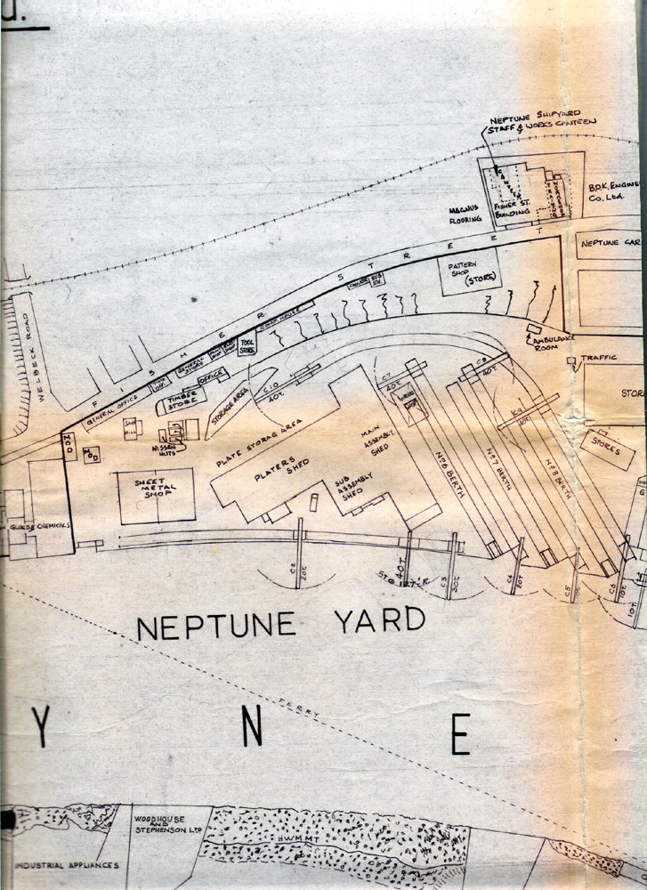

Postby Terrysummerson » Mon Oct 06, 2014 12:44 pm
A list of the Yards facilities circa 1990
NEPTUNE YARD FACILITY
PRE FAB SHED AND SUB ASSEMBLY SHED
The main pre fab shed has an area in length of 423 ft. x 98 wide.
Pre-fab area 300 ft. x 90 ft it also contains two pin table gantry
for pre-fabricating shaped shell panels. These are 33 ft. x 33 ft.
There are two 20 ton cranes on upper crane gantry, and one 10 ton
crane on lower gantry units of up to 40 tons can be pre-fabricated. There
is a 40 ton lifting beam, situated in shed but a 50 ton beam can
be loaned from Wallsend Shipyard if required. The main door width
to transfer track crane is 57feet wide and 32feet in height from base.
The 20 ton cranes knock out is 52feet from base this gives ample height
for units. There are two sets of 20 ton lifting chains and shackles
in shed. When units are finished they are taken out to a transfer
track outside of pre-fab shed for transporting by 40 ton crane to the
building berths Nos. 6, 7, 8. These berths are chauffeured by
cranes of up to 40 tons at head of berths and 10 ton cranes at end
of berth. See layout sketch. The 20 ton crane track is extended 31feet
outside of pre-fab shed.
