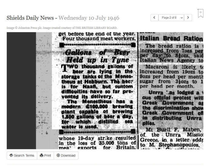

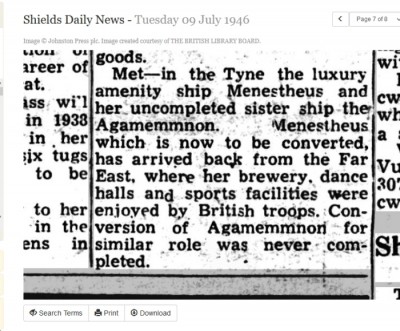

The following articles suggest that the Wiki entry is inaccurate in that MENESTHEUS was completed and went to the Far East whereas AGAMEMNON was not completed.
Copyright of the Shields Daily News
